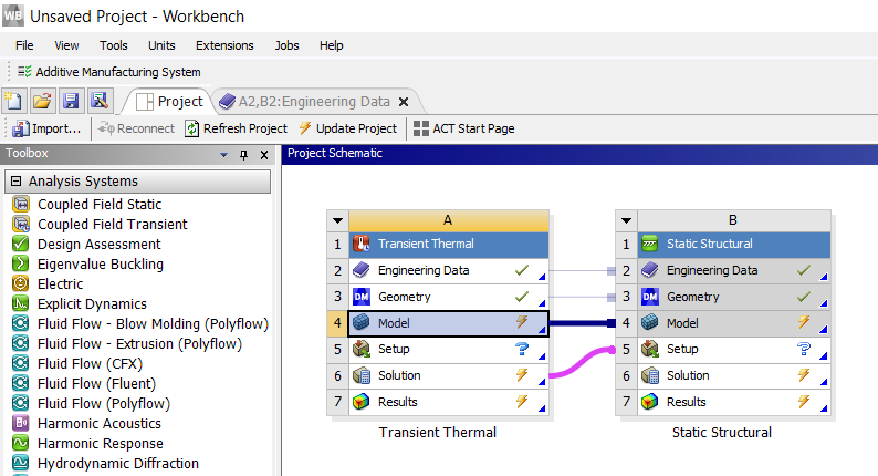

I am using Ansys workbench with the extension AddtitiveWizard.
From the guidelines, it is supposedly pop up AM transient thermal and AM static structural here but mine is not. is it the same? or will it affect the simulation?
August 10, 2021 at 5:58 pmJohn Doyle
Ansys EmployeeIt is hard to say for sure what the issue is. It looks like you have enabled the Additive Manufacturing Extension from the project page. Is the issue with part scoping unique to just one part file or is it common to any part? If it is common, you might want to try to uninstall and reinstall the application. If it is unique to just one part, perhaps the file is corrupt in some way. Can you mesh it and solve a conventional thermal-structural run without the AM wizard?
Also, I see you are running R2019-R3. It would be best to upgrade to latest release if possible.
