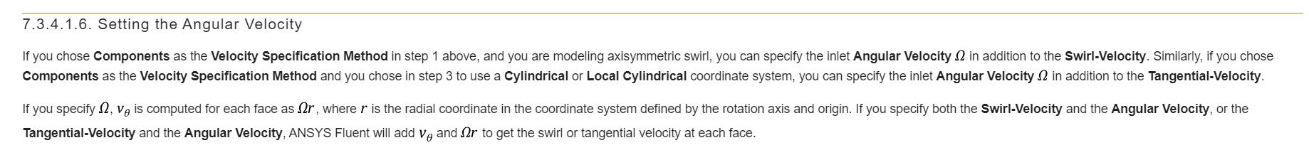

      Right now, i am solving the problem in ansys Fluent.
      I want to introduce swirl velocity at the inlet, since i am working on 2D model. I have inlet velocity of 7.437m/s and swirl angle 45 degrees caused by Fins. The radial velocity in this case is assumed to be zero.
      I need help in solving the Swirl/ tangential and axial velocity components.

      Please refer to section 7.3.4 - Velocity Inlet Boundary condition in the Fluent Users Guide.
      I have attached a small snippet from the same section here. I hope this helps.

      We have options to define swirl velocity under velocity boundary conditions.
      Under co-ordinate system, you can choose cylindrical swirl and provide swirl boundary conditions.
