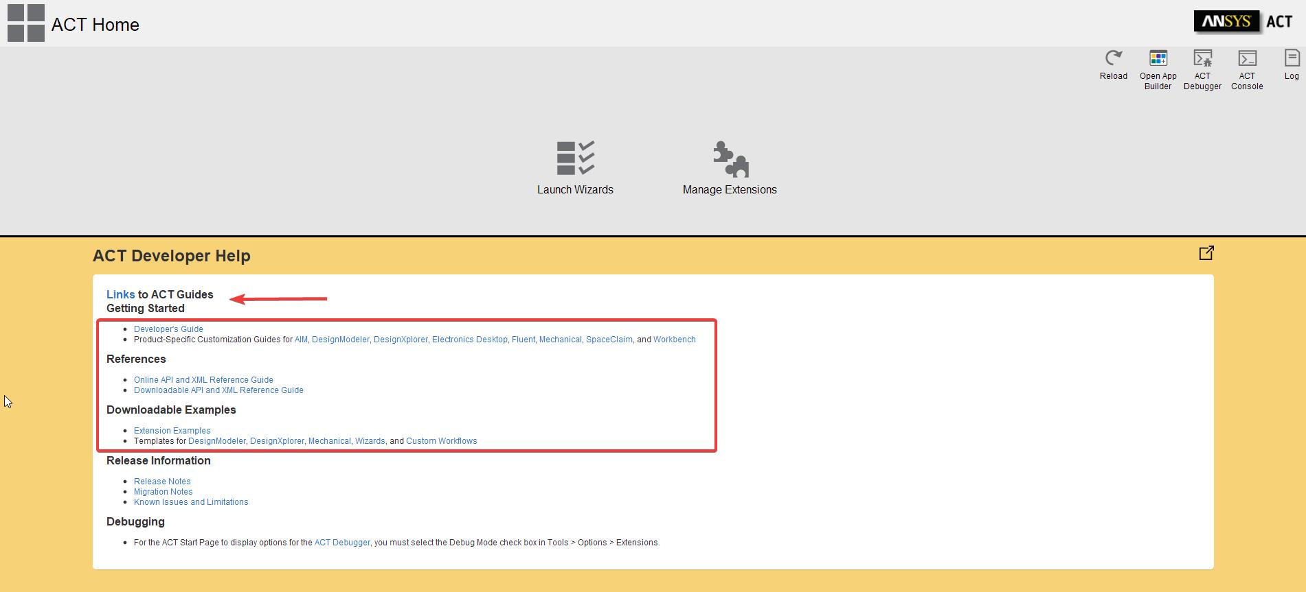

      Yes, you can do this using ACT scripting or probably using APDL scripts as well.
      I would say, start with the links provided in the ACT Start Page (In WB, under Extensions)
    • Sandeep Medikonda
      If you have a named selection for the vertices. We could use a command like "NUMMRG,NODE,,,SELE" to find nodes that are coincident and create joints between them.
