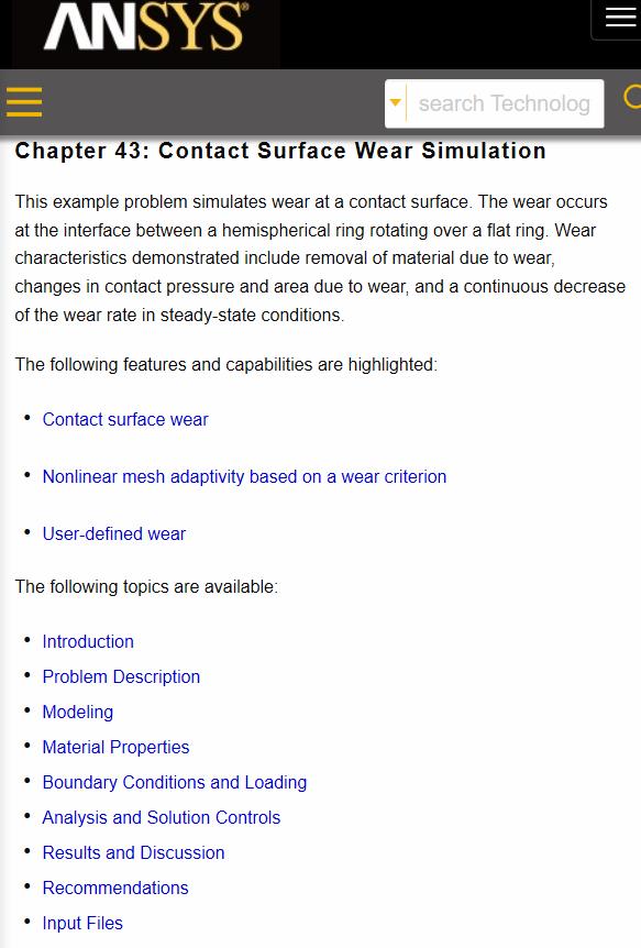

      Did you read Chapter 43 of the Technology Guide on Contact Surface Wear Simulation?
