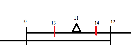

I want to put some IFs in my APDL code to order four keypoints in a beam. One of these IFs has 3 inequalities:
KP 11 < KP 14
KP 13 < KP 11
KP 14 < KP 12
Obviously i'm talking about their distance from a coordinate system.
How can i write them?
*IF,KP11,LT,KP14,AND,KP13,LT,KP11,THEN
other ELSEIF conditions
*ENDIF
The third condition is missing...
April 6, 2022 at 12:28 pmChandra Sekaran
Ansys EmployeeWhy not do just nested *IF
*if,kp11,lt,kp14,then
*if,kp13,lt,kp11, then
*if,kp14,lt,kp12,then
*endif
*endif
*endif
April 8, 2022 at 12:55 pmVKant
SubscriberThanks, i'll give it a try!
For the moment i solved the problem with some equations and the model works well. I'll try this method later.
