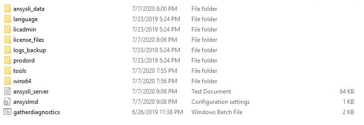

      Hi, I added firewall exception to ansyslmd.exe as suggested during installation. I am running the software via university server. I don't have access to the license server machine. My license_files folder doesn't have any .lic files. Should I request my university IT admin to make this change or is there an other way to do this? I am including images of my 'Licensing' and 'license_files' folders
      I tried to run the software by switching off my windows firewall but that didn't help. I would prefer not to do this if there is an alternative. Thank you.
      Licensing folder contents
      license_files folder contents
    • tsiriaks
      All of these must be done on the license server machine. Please ask your IT to assist. There is no way around it, it's blocked on the server side.
