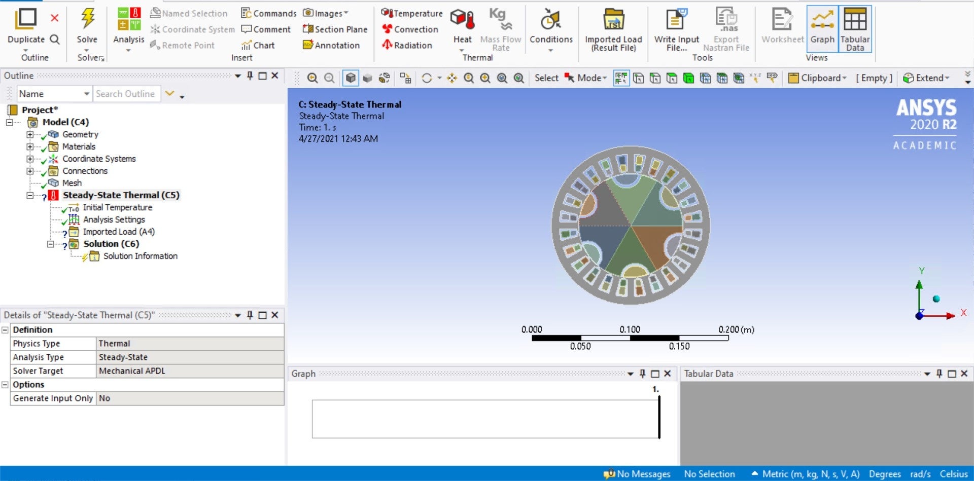

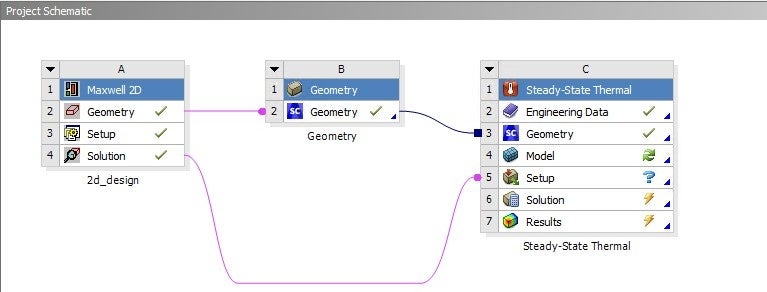

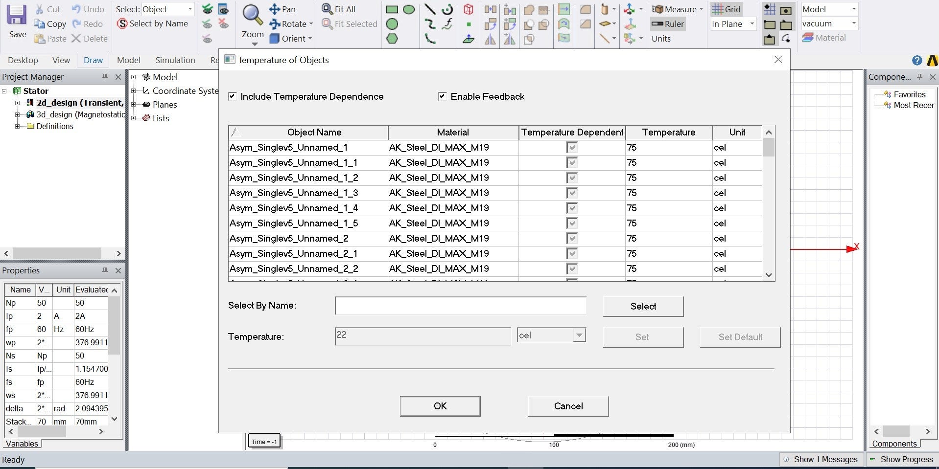

      Hey guys,nnI'm working on a SynRM model for my research group. I've got the Maxwell results and I'm trying to couple Maxwell with Steady-State Thermal simulation. I'm running into an issue because when I connect the Maxwell solution with Steady-State Thermal Setup, I open Mechanical only to find the imported load (A-4) folder to be empty. I've attached screenshots of my workbench, Maxwell object temperature setting, and Mechanical with the post.If anyone can help me out with this, that'd be great!nn

      Please look into this example to understand how to transfer your Maxwell solution to Mechanical (steady-state thermal). Hint: Please use the System Coupling module.
      https://ansyshelp.ansys.com/account/secured?returnurl=/Views/Secured/corp/v211/en/sysc_tut/sysc_tut_coilcore_mech.html
