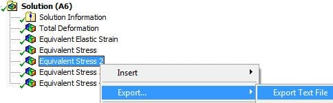

      I'm still not sure exactly what you want to export to excel all at once. Do you mean you right click on a stress plot and get the Export menu and pick Text file?

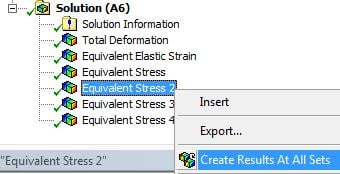

      In the screen snapshot below, I have four Results for stress. This model had multiple time steps. If I right click on one I can create a stress plot for each time step.
