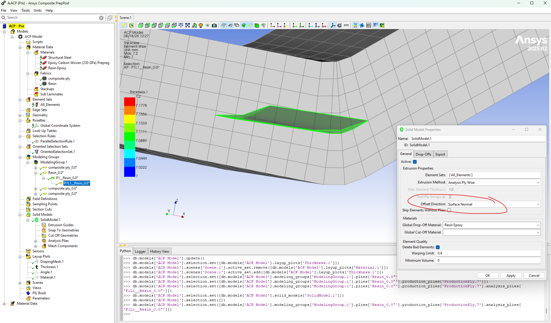

Ansys EmployeeHi Eric,
Try using Solid Model option for "Offset Direction = Surface Normal". It accounts for local extrusion direction adjustment based on the solid element faces and not on the the reference shell mesh. This approach would work to some extend if you have local plies in the curved area. This would be required also when building the part, otherwise you'd face bridging issues in the radius area. However this will also be limited depending severity of the part thickness to radius ratio - as you see it also in reality. Check out the attached snapshot where you can see the adjusted extrusion direction due to the "Surface Normal" option. The local ply represent a resin pocket or a some ply with local boundaries to fill the potential void:Â
If that doesn't work you might also use Imported Solids and mapping. Be cautios for solid element orientation - ply normals need to be well aligned solid element normals. If these methods do not help sufficiently, I'd like to advise to open a Support Case.
Regards
ThomasÂ
