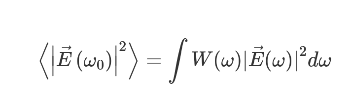

FDTD gives pure, single wavelength in coherent way. It does not consider any incoherence or partial coherece. However in experiment, if you do not use laser source, for example, you use nature light or florescent light or other incoherent sources, they are incoherent thus the ripples are averaged out. that is, the measured result is like this
 where W is the spectral weight of the source. More information maybe found here https://optics.ansys.com/hc/en-us/articles/360034383074-Understanding-temporal-incoherence-in-FDTD
