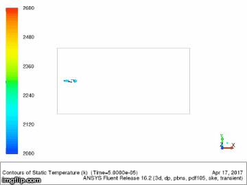

November 14, 2018 at 4:04 am
anilwakale
If you see the Time is 5e-5 and my starting time itself was 1e-6 and I plotted with 2000-2600 temp range
so in this gif. we are not getting any ignition delay. using Steady diffusion flamelet model. I have to simulate the same case as given below (link)
https://www.youtube.com/watch?v=b6wfODEp0VE
Not with LES but with RANS using Fluent. We are getting above lift of length for non-reacting spray but in reacting our spray will start combusting as soon it enters into the chamber. In the link above its clear that spray will come in liquid form enters into the hot environment and with some Ignition delay spray starts combusting. Do you suggest any tutorial for it? Initial conditions of the chamber are mimic of ECN spray A expe. (Pin=61MPA, Tin=900K, fuel Temp=363K and rest all BC)
November 14, 2018 at 9:10 am
Amine Ben Hadj Ali
Ansys EmployeeI recommend using LES and detailed reaction mechanism with EDC or FGM.
For the ignition delay you can check if one of the methods in Fluent are suitable or not.
