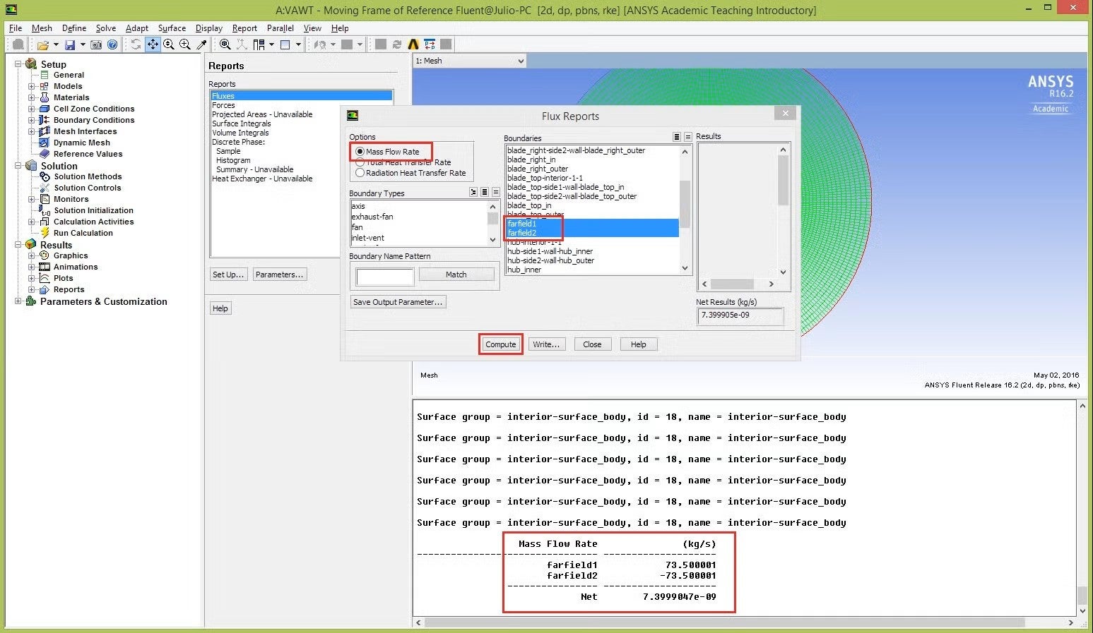

To do this, we will use Fluent. Open Fluent from Solution.
Highlight "Reports" in the left box. Then select "Fluxes" and click "Set Up."
Note that "Mass flow rate" is already selected.
Here you can play around to see the mass balance through each boundary. Since most of our boundaries are single circular elements, it is expected that the imbalance at each boundary alone will be zero. We will check the mass flow rate though two boundaries.
First, the external boundaries. In the "Flux Reports" window, locate and highlight "farfield1" and "farfield2" and hit "Compute." The mass flow rate though that boundary is now printed in the command window.
Note that 73.5 kg/s get into the out domain and virtually everything leaves. The imbalance is 7.4e-9 kg/s, which is negligible considering the total amount of flux in the system. Nice!
