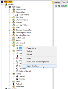

2. Right-click on “Solution” and select "Export Results..." (see the screenshot in the attachment).
3. On the “Path” field, select the “acp_export.csv” previously created.
4. In the “Definition” field, select the result of your choice from the drop-down menu.
5. In the “Entities” field, select the Element Sets of your choice.
