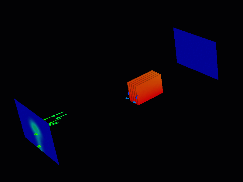

In this simulation example, you will learn how to set up a problem in Ansys Fluent to calculate the heat transfer rate dissipated by a heat sink due to conductive and convective heat transfer modes. You will simulate the flow of cold air over the heat sink heated from its base and learn to estimate the heat loss from the sink.

Let us now look at the simulation results and analyze them.
