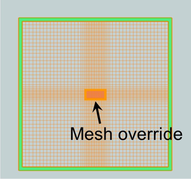

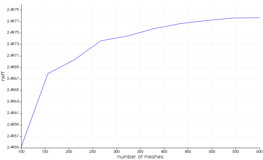

Convergence testing of the number of mesh cells used, or mesh step size used, can be done to reduce error due to discretization of the mesh:

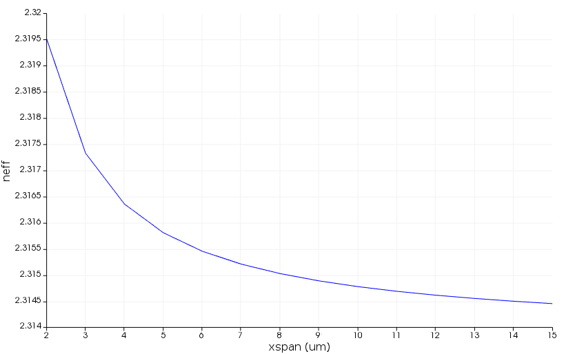

Convergence testing of the simulation region y and z span settings can be performed to reduce error due to having the boundary conditions too close to the structure:
